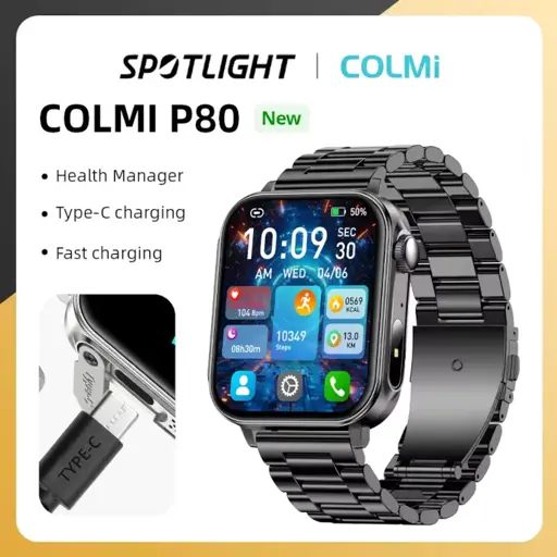

          I wrote the post above. So far, the USB-C watch has lasted over 3 days and still has over 50% battery power.
          Obviously, at that price it isn’t running a cellular radio or GPS. BLE is amazingly efficient - as are the built in sensors.

              What’s the battery size?
              The website claims 280mAh. That’s a smaller than the newest Pixel watches - but then it is only about 10% of the cost of those models.
              The point is USB C is noticeably larger than pogo pins for the sake of including a whole bunch of additional pins a smartwatch has zero use for.
              Agreed! But that rather depends on what you want to use it for. This model is charge only. But it could be useful to use it as a USB drive to store music, or to get health data off it. The main advantage for my personal use-case is being able to charge while wearing it.
              The ideal state for a smartwatch is having an always-on display and heart rate monitoring, among other things.
              Yes! This does have always-on heart rate monitoring and step count. The screen is only on when you glance at it or tap the button.
              And if it’s not a standard, then it’s not fixing the problem.
              Agreed! But as the Pixel watch has gone through three different charging standards, all of which are incompatible with other watches, we don’t seem to be any closer to solving that problem with wireless.
              And all that’s even before you begin to consider that watches are more comfortable to charge when they have a stand to do so, since they’re small, light and fiddly
              That’s a personal preference. My Pixel watch stand is fiddly to use - the magnets don’t always align. And the puck charger is pretty lightweight and moves around easily. By contrast, my lightweight USB-C cables don’t move my watch when it is charging directly.
              Standards need to be standard.
              I agree! But sometimes it is nice to experiment with things to see what works. And I’m very happy that this normal-sized watch is able to charge with the same cable I use for my toothbrush, eBook, headphones, fan, and phone.

        Liking that! Pros and cons? I’m pretty damned rough on my gear, why I almost exclusively wear Casio. Water is a serious concern for me.
        • edent@lemmy.world
          Pros? It is cheap, it uses USB-C, step counter and heart monitor work, bluetooth calls work.
          Cons? App is a bit crap, but works with GadgetBridge. UI is a bit slow and janky. Lots of watch faces but you can’t design your own.
          Full review on my blog later today.

    Watches are small, but the USB-C connector isn’t massive.
    The USBC plug may not be “massive” but it still adds more bulk to the watch.
    it might be rubbish as both a watch, Android device, and masc-coded jewellery - but it shows that USB-C is viable for devices of this class.
    just because cheap ass watches use USBC ports doesn’t mean it’s a good idea. you need to know how these USBC watches actually hold up in the long run before you make that judgement.
