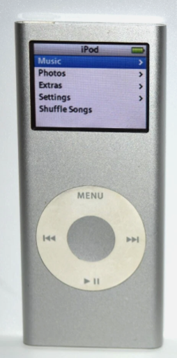

I still have an old ipod. So old it has no wireless ability. I want to use it in my car which doesn’t have a cassette or cd player. It plugs into the car’s usb port but the car radio “doesn’t see it”. Any tips on how to get it to work?

      Sorry I don’t understand your response. This old ipod is loaded with music down loaded from itunes. If I plug head phones into it (it has not bluetooth) it works fine. If I plug it into my stereo receiver in the house it works great. But if I plug it into the usb port in my car - it is not recognized. Any suggestions would be appreciated.

        Other people replied, but to rephrase: the USB will not work with a car, and there will never be an adapter that will allow it to.
        Instead you need a way to send the audio from the ipod headphone jack into your car stereo. Something like this.
      • Strider@lemmy.world
        7 months ago
        I think I can clear up your confusion.
        By headphone jack there’s a transmission of simple analog audio.
        By USB however there are endless possibilities.
        Ipods (and other apple devices) usually spoke a different protocol than simply providing file access as your car is likely expecting. On a pc you needed to install the application for that, too.
        That’s likely the reason for not working.
        In this case it’s easier to just stick in a mass storage usb stick with music files on it.

    It is likely the car USB port is looking through directories for MP3 files, and thats not now those iPods present themselves when hooked up via USB. You might be able to find an audio-to-bluetooth adapter, but it is likely you will not be able to control the device through the car’s interface, so you would have to press play manually.
    (Side note: older cars with USB might have a very low-level relationship with the USB sticks, where they read files in the order they were written to the device, without regard to what folders you put them in. There are utilities that can reorder the files’ physical position on the stick so that albums play in order)

    I’ve had one of those (battery died, unfortunately) and if you’d look at its files, you’d notice that they are organized in a different structure than what an MP3 player might expect.
    iPod_Control\Music’s sudirectories might contain some songs, but the filenames are hashes (corresponding to the entry in the iPod db). The metadata and the contents are perfectly fine, and you can play the file yourself via a different player (you can probably test it in your computer).
    I suggest you just connect the iPod through the 3.5mm output audio jack or find a 3.5mm audio output to Bluetooth transmitter adapter.

    The USB port in your car radio might only support a specific file format for the drive (like EXT, FAT32, NTSF) that the iPod doesn’t use (IIRC, the iPod used Fat32 or Fat16?)
    Or it doesn’t see directories and would work with a plain USB stick loaded with .MP3s loosely added to it. You could get a iPod to do this, but it wouldn’t work as an iPod anymore; it would be an external hard drive.
    Edit: NVM I just realized it’s a nano. You can’t use the USB to play anything from a nano.
    Does the radio have a 3.5mm AUX jack? If so, just use that.

    The reason the USB plug on your ipod doesn’t work is that earlier audio devices like the original ipod didn’t have a way to transmit audio digitally over USB, it was only used for charging and file transfer.
