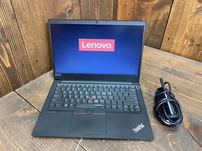

I have a e14 Thinkpad gen 5 Intel 1335u with 8gb soldered ram and a 8gb 3200 ddr4 stick. 16 is not enough ram for my use as a developer so I put a 16gb stick in knowing only first 16 will run dual channel. Now my computer crashes randomly with high memory usage… read online that a 32gb is more stable single channel but I’m skeptical. Stability is pretty important to me as this is how I earn a living what do you all think? Also I would just buy a 32 and try it but everything got pricey the last 2 month
s
EDIT: ran memtest after crashes got worse, went back to stock 8gb and gave up. Some weird issue with used 16 stick

    Reseat the stick you installed and run memtest 86.
    It’s more likely that you have a badly installed stick or a faulty stick than consumer memory controllers in the last 20 years care about the installed memory being the same.

      yea it’s a 16gb but yea I agree. although it was in my server for 3 years(laptop that cooked itself)! Going to run memtest here in a minute and will post my findings on all sticks I have around once I’m done with work

        Wait… It’s a used stick? For future reference, that’s a key piece of information. I’m guessing it had a life before it was a server, making it older than 3 years. Depending on the history of the old laptop, I’d guess there’s a solid chance that stick is just worn out.

          haha used is an understatement. was in a gaming laptop running frigate at like 90 degrees for 3 years. the other stick is a crucial 2666 16gb I have from same laptop. I’m too lazy to run memtest when I know there’s an issue. going to try slower speed and do the testing

    I’d give going back to 2666 Mhz a shot. Might gain some stability if the timings are clashing.

    I have an E16 gen 1 AMD that I run in a similar configuration- 8 GB soldered + 16 GB SODIMM. I’ve had no problems.
    I’d recommend what others have suggested - try reseating the RAM and run a memory test. Also, what distro are you using, not that it’ll necessarily help.

      ubuntu fresh 24.04 install. also it’s still usable as is but crashes before I hit 24gb usage

          nothing haha just left the bad 16gb stick in there because it mostly works. It’s hard to diagnose it as I use it for work 24/7… mayb I need another Thinkpad for when I diagnose the other

            Very weird, ram sticks should work to the lowest freq if the soldered one is lower freq.

            you already said in another comment something like “im too lazy to run memtest” i dont get it, why not just run the test and that will likely diagnose?
