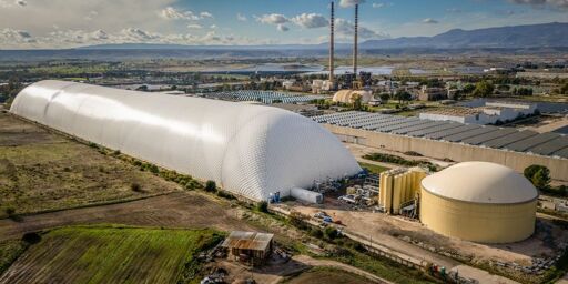

"This giant bubble on the island of Sardinia holds 2,000 tonnes of carbon dioxide. But the gas wasn’t captured from factory emissions, nor was it pulled from the air. It came from a gas supplier… “The facility compresses and expands CO2 daily in its closed system, turning a turbine that generates 200 megawatt-hours of electricity, or 20 MW over 10 hours.”

On their website (energydome.com) they claim “75%+” round trip efficiency, so not a bad guess!
That’s a hell of a lot better than most other systems. If true, and if scalable, this is a huge innovation.
compressors, turbines (like steam turbines), piping, some of which heat-resistant (500C), container for liquid carbon dioxide, lots of plastic for the bubble, something for thermal storage, dry and clean carbon dioxide, these aren’t unusual or restricted resources, don’t depend on critical raw materials or anything like that
Compressed air without heat recovery is more like 30%, so this is huge

This CO2 is acting as a reusable fluid in a closed loop. The initial capture of the CO2 costs energy, but the battery keeps using the same CO2 over and over again. So the question of efficiency should be more about land usage and maintenance of the rest of the parts and the labor needed for each megawatt stored vs what other grid scale energy storage costs in materials and labor.

There is a thermal energy storage included as s major part. This works because compressing CO2 to 55atm adiabatically heats it up to some 450-ish C, so that heat is pretty high grade, and only the final stage cools it down with heat exchanger open to air. In discharging direction, some heat is taken from outside air to evaporate part of CO2 and heat stored is used up

We had these things called Gasometers in the UK for a long time. They expanded with the amount of gas stored in them, and they kept the pressure of the local gas supply up. A local gas reservoir, or “gas battery” if you like.
These bubbles are basically the same idea but at higher pressure.
It’s still near atmospheric pressure. Liquid CO2 expanding is powering the gas turbines.
Ah the bubble is the expansion volume. Not the storage volume… got it. I had it backwards.
So yes, very similar then.

Also from the article:
If the worst happens and the dome is punctured, 2,000 tonnes of CO2 will enter the atmosphere. That’s equivalent to the emissions of about 15 round-trip flights between New York and London on a Boeing 777. “It’s negligible compared to the emissions of a coal plant,” Spadacini says. People will also need to stay back 70 meters or more until the air clears, he says.
People will also need to stay back 70 meters.
Huge amounts of carbon dioxide can be far more dangerous. The Lake Nyos disaster has killed over 1700 people, at up to 25 kilometers distance.
160km/hr as per TFA.
Guilty, I only skimmed it. Thanks.
And if there is a known high wind coming, the plant can forcefully go through the compression cycle to remove the bubble.
That’s really not that big of a wind. One bad storm and we have it burst
Also, per the article, the danger zone in a burst is only claimed to be 70m until cleared and the CO2 release still pales in comparison to a regular coal plant - “equivalent to 15 round trips between New York and London on a Boeing 777”
The article also mentions that they can deflate it in around 10 hours

On the downside, Energy Dome’s facility takes up about twice as much land as a comparable capacity lithium-ion battery would. And the domes themselves, which are about the height of a sports stadium at their apex, and longer, might stand out on a landscape and draw some NIMBY pushback.
This is surprisingly good! I would have figured it would have taken far more than twice the land than a Lithium battery solution.

Wonder how small you can scale these and retain efficiency, at twice the footprint (but I’m guessing a lot more volume) of a lithium grid battery, will we see these replacing home batteries down the line?
They are talking hectares in this and it looks like the power density is below that of batteries, but its also cheaper per MWh.
