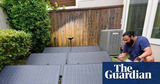

Tweaks to state laws mean many Americans will be able to benefit from small, simple plug-in solar panels
Acquiring solar panels at home can be an expensive hassle for people in the US. But small, simple, plug-in solar panels for use on balconies are soon to become available for millions of Americans, with advocates hoping the technology will quickly go mainstream.
Earlier this year, Utah became the first state in the country to pass legislation allowing people to purchase and install small, portable solar panels that plug into a standard wall socket.
When attached outside to the balcony or patio of a dwelling, such panels can provide enough power for residents to run free of charge, home appliances such as fridges, dishwashers, washing machines and wi-fi without spending money on electricity from the grid.
Balcony solar panels are now widespread in countries such as Germany – where more than 1m homes have them – but have until now been stymied in the US by state regulations. This is set to change, with lawmakers in New York and Pennsylvania filing bills to join Utah in adopting permission for the panels, with Vermont, Maryland and New Hampshire set to follow suit soon.
