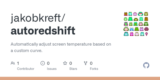

Hi!
If you’re using redshift on Linux, I made a small tool that might be useful. It automatically sets the screen temperature based on the current time, you just draw a curve for how you want it to behave during the day. Then you can just add it to crontab to run every minute or hour.
