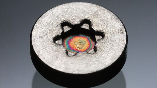

“The isotope of interest for space is americium-241…Its half-life is a staggering 432 years, five times longer than plutonium-238.”

    In the UK, large stocks of civil nuclear waste contain significant quantities of americium-241. That makes the fuel not only long-lasting but also readily accessible. Instead of building new reactors to produce plutonium, agencies can extract Americium from existing waste, a form of recycling at a planetary scale.
