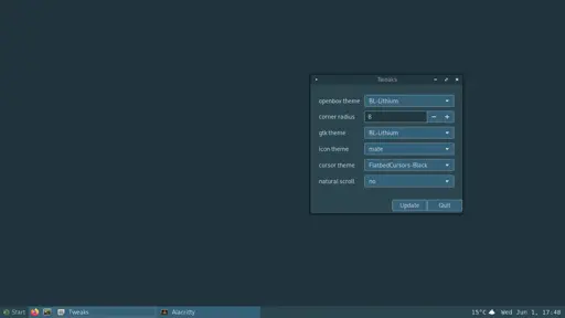

Could Wayland be possible with these hardware limitations? If so, how should I setup it? I guess labwc (pictured above) is the best fit for a Win9x experience, but what is needed afterwards? LXQt or Xfce or something else?
