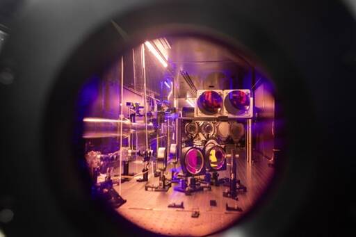

      It’s no different than an engine producing power. I think you are confusing it with “energy”.
      • Echo Dot@feddit.uk
        26 days ago
        No the laser didn’t produce anything the laser is powered by a power source, and that power source produced that much energy.
        It’s like saying that an ultrasonic saw produces power, no it doesn’t, you already have to have that power to feed into the ultrasonic saw.
        • 3abas@lemm.ee
          26 days ago
          The laser didn’t generate 2 quadrillion watts like a power plant would generate electricity, but it delivered that much power in an extremely short pulse, like 20 quadrillionths of a second.
          That means the energy it delivered was relatively small (a few hundred joules), but because it was delivered in such a tiny time window, the power (which is energy per unit time) was immense.
          The laser did produce power, in the form of intense light and heat, over a very small time period. It converted 2 quadrillion watts of electric energy into a very brief laser pulse.

    Edit 2: Eheran pointed out I screwed up the math. Correct total energy output is 13μWh. A very, very, very small amount of energy.
    (2x1015 W) * (25s/1x1018) * (1 h/ 3600 s) = 13μWh
    Previous bad math:
    spoiler
    The key thing here is the burst lasted for “25 quintillionths of a second long”. Meaning it had a total output energy of 180 W/h, or how much energy a standard US space heater (1.5KW) outputs if it was on for 7.2 minutes.
    That is a pretty impressive amount of power coming in instantly to a small spot. Would leave basically zero time for it to dissipate into surrounding materials.
    Edit: Fixed the math. (I hope) (2x1015 W) * (25/1x1018 s) * (3600 s / 1 h) = 180W/h

      You multiply seconds with seconds per hour and somehow get “per hour” as the final result? But even ignoring that error, what is W/h supposed to be? Rate of change of power?
      • Eheran@lemmy.world
        27 days ago
        Also, it is a small k for kilo and you don’t write it as 4.31018[unit]. Just 4.310^18 [unit]. Or 4.3E18 [unit].
        • BombOmOm@lemmy.world
          27 days ago
          Crap, you are right, units should be in Wh not W/h and as a result I put the conversion to hours backwards. Well, that turns the whole thing from an impressive amount of energy to basically none!
    • NoSpotOfGround@lemmy.world
      27 days ago
      That’s 25 attoseconds, no?.. If so, that’s impressive.
      The power record holder right now is the Măgurele laser in Romania, at 10 PW, but it lasts a thousand times longer, at 25 femtoseconds I believe. I can’t find clear info on pulse duration anywhere. They do intend to decrease pulse durations it seems.
