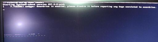

Anyway, a few hours ago today, when I turned on my computer, went to the systemd-boot boot loader, chose “Arch Linux” from the list of boot entries, I was faced with a system that is stuck at boot as seen from the image I uploaded.
So far, I’ve tried disabling Overdrive by editing the kernel parameters at boot, and by booting an Arch Linux live ISO to no avail. As in, I’m stuck at the same stage of the booting process, even when using the aforementioned live ISO. Which means I can’t really boot into the system.

EDIT: Changed the GPU to a different PCIe slot and everything’s working fine so far. I’m not celebrating just yet because when this first happened a few months ago, I’d hard reset the PC and everything would work fine. But if I shut it down and let it pass like 12 hours before I’d power it on again, the problem would reappear. So I’m just basically waiting for tomorrow now.
Final EDIT: Yep, it was the PCIe slot. Left it powered down for about 12 hours, booted it up and everything works fine. Thank you again to everybody who chimed in with suggestions.
