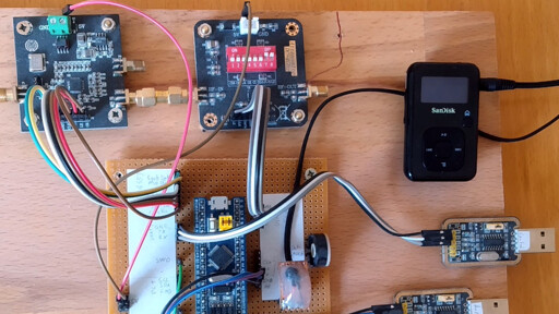

    I have that exact SanDisk, rocking a rockbox firmware – glad to see its still seeing life
      Me too! Only in blue. I have no idea where mine is now, sadly.
    • dorumon@lemm.ee
      I have that exact same SanDisk player as well rocking rockbox firmware and it’s now my portable game console at work.
