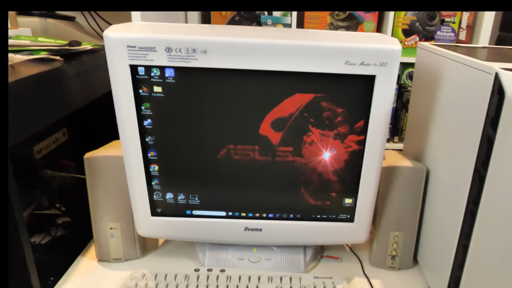

    It makes sense you’d be able to get a much higher refresh rate on a tube if you reduce the resolution, since you would be reducing the beam’s travel.
    • deranger@sh.itjust.works
      11 months ago
      Changing the resolution on a CRT normally doesn’t make the picture smaller. There is no native resolution, phosphors are not pixels. My Viewsonic would display 640x480 or 1600x1200 on the whole 21” regardless. You can also watch the video, it’s not using a smaller area.
      I believe the limitation is bandwidth, not the electron beam.
      • bionicjoey@lemmy.ca
        11 months ago
        Yeah I didn’t think it would make the “pixels” smaller, but the beam would need to pulse less often and therefore could travel more. Maybe I’m misunderstanding what they did.
          11 months ago
          Electron beams scan insanely fast, that isn’t the limiting factor. Getting that much bandwidth across a VGA cable is tough. If you wanted super high refresh rates on old CRTs you’d have to drop the resolution. Same concept.
            11 months ago
            Ah. I see, so reducing the resolution was more about sending frames to the monitor faster, not about optimizing the tube hardware’s behaviour
            • Dave.@aussie.zone
              11 months ago
              Yeah basically you can only signal “on-off” so many times a second in a vga cable before the ons and offs get blurry and unusable. So you can trade lower resolution for a higher frame rate as long as you keep the total number of on-offs below the limits.
