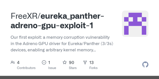

This recent work https://github.com/FreeXR/eureka_panther-adreno-gpu-exploit-1 makes the latest headset with a rather recent update (but NOT the very last ones, so be cautious!) rootable.
