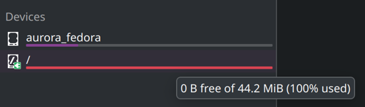

For some reason Calibre won’t let me do anything because “drive is full” which I assume has to do with this.
Update: I believe I “fixed” the error with Calibre by using FlatSeal to add environment variable CALIBRE_TEMP_DIR that changes the Temp directory to something else. So far that’s the only program I’ve seen give trouble.
That is your / (root) partition. You can’t write to it because Aurora is an atomic & immutable distro.

How’d it get full then? And if it’s supposed to be 100%, any ideas on how can I get Calibre (so far the only app I’ve noticed that is giving trouble) to ignore it?
It comes full from the first boot, because you’re not supposed to be able to write to it. That’s kinda he point of an immutable distro
Got it thanks, I think it’s weird it shows up in Dolphin this way but at least I know what it is now.
Yeah, I get that. But also, the root mount point is a valid partition, and it is full, so it makes sense why it shows up that way.

Fedora Atomic Desktop 42 switched to composefs, which has a small full partition mounted to
/. Your “real” filesystem is mounted on/sysroothttps://fedoraproject.org/wiki/Changes/ComposefsAtomicDesktops
That makes sense, thank you! How can I clear up space in it?
You can’t, it just part of how Fedora works now. Maybe Fedora should patch Dolphin to take /sysroot into account instead of /
You don’t, it’s the immutable root partition. You probably need to find the point it’s trying to write to and link it to a location it can write to.

You were correct, I believe I “fixed” the error with Calibre by using Flatseal to add an environment variable
CALIBRE_TEMP_DIRthat changed the Temp directory to something else.

That’s the root partition, which is the core system partition. It’s probably read only because Aurora is an immutable system, that means that it doesn’t let you write to the system partition by default
From https://docs.getaurora.dev/ “System updates are image-based and automatic. Applications are logically separated from the system by using Flatpaks for graphical applications and brew for command line applications. Workloads for development are containerized.” Correct me if I’m wrong, I’ve never heard of this distro before

Not clear, the “drive” doesn’t show up in partition manager.
Not mounted by default I assume
Launch Partition Manager and find out. It’s probably boot or efi.
It’s not in partition manager actually!
Fyi if you find it annoying to see this this everytime you open Dolphin, you can right-click it and set it to hidden

It’s smol, probably your boot partition, or some rogue partition got created during OS installation
